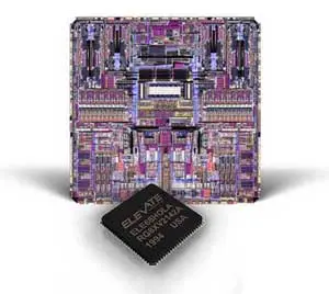

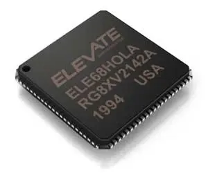

Among ElevATE portfolio solutions is the Venus 4 (ISL55161), a highly integrated SoC incorporating a dual channel 400MHz/800Mbps pin electronics differential driver and comparator, active load, timing deskew, PMU and DAC. Available in a 64-Lead 10mm x 10mm TQFP and in a 64-Lead 9mmx9mm QFN package, the SoC features a Pdq ≤ 500mW/Channel @ 11V Operation.
VENUS 4
Venus 4 (ISL55161)
Figure 1: Venus 4 (ISL55161)
