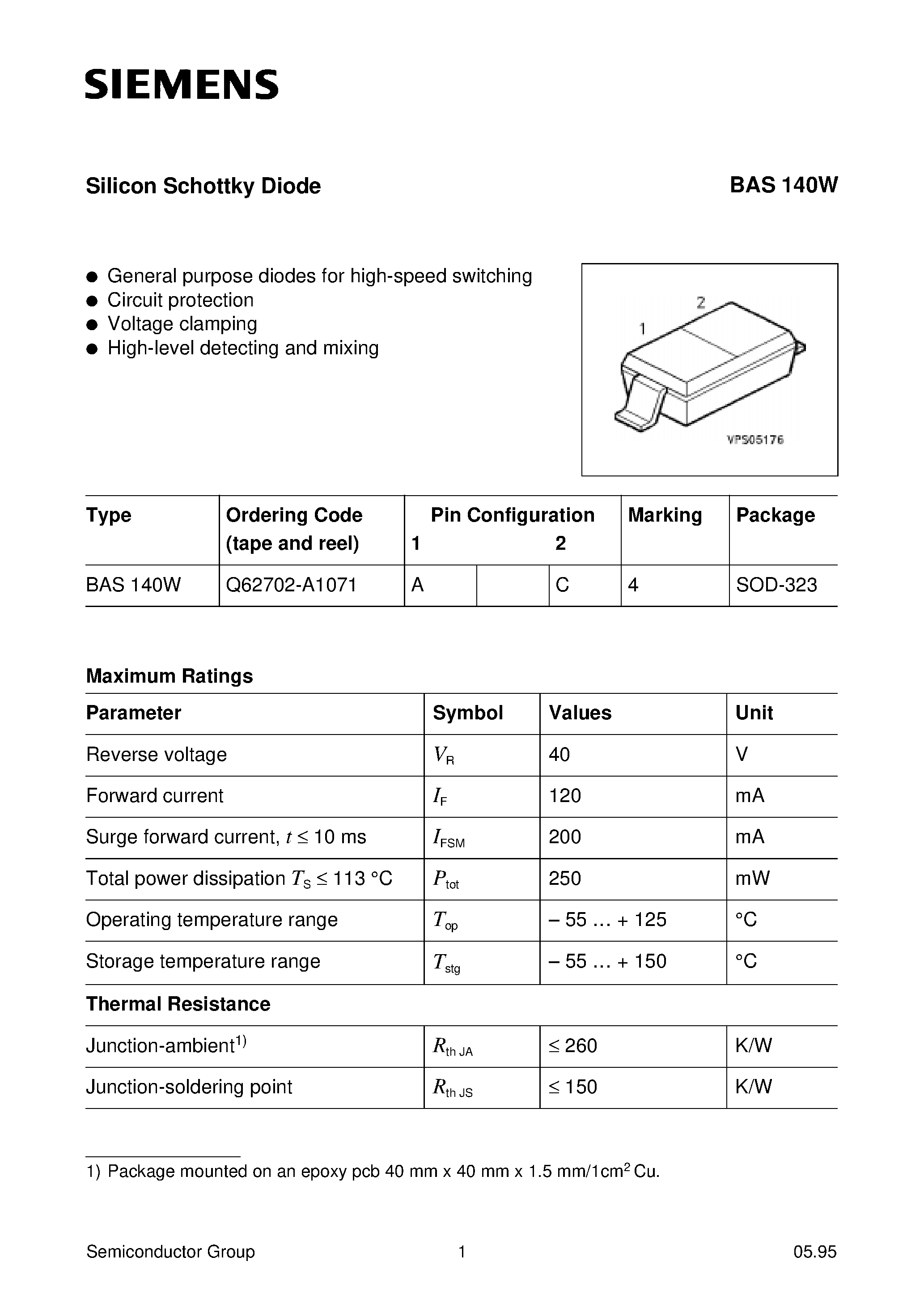

BAS140W-Silicon Schottky Diode (General purpose diodes for high-speed switching Circuit protection Voltage clamping High-level detecting and mixing)
Наименование:BAS140W
Описание:Silicon Schottky Diode (General purpose diodes for high-speed switching Circuit protection Voltage clamping High-level detecting and mixing)

Даташит BAS140W - Silicon Schottky Diode (General purpose diodes for high-speed switching Circuit protection Voltage clamping High-level detecting and mixing) страница 1

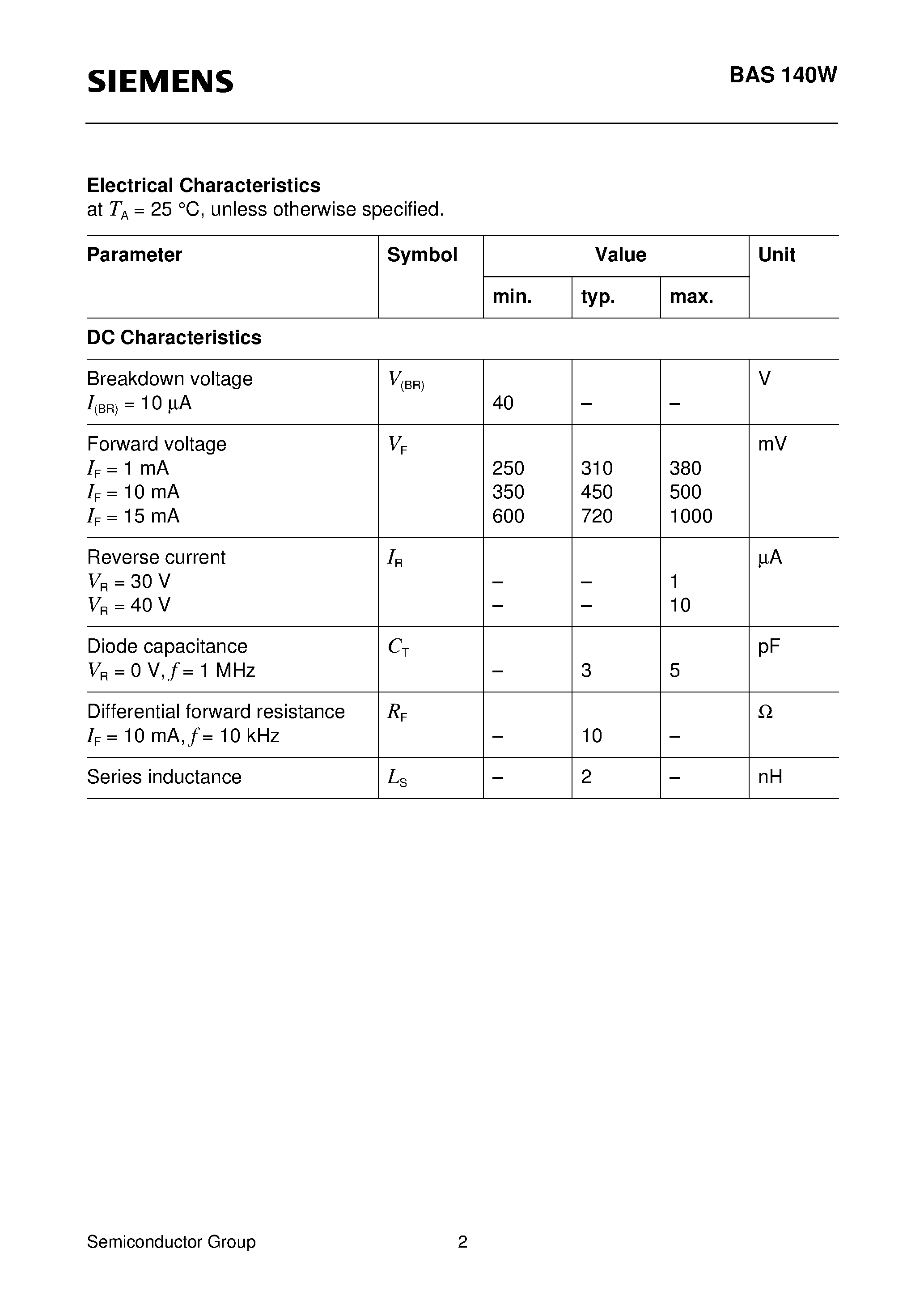

Даташит BAS140W - Silicon Schottky Diode (General purpose diodes for high-speed switching Circuit protection Voltage clamping High-level detecting and mixing) страница 2
