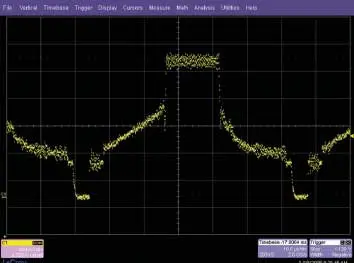

   Figure 5 shows an attempt to repetitively capture this same composite video signal using a LeCroy WaveSurfer 400 Series oscilloscope. This oscilloscope has a special user-selectable display mode called Analog Persistence, which is a technique used by LeCroy in an attempt to emulate the display quality of an analog oscilloscope. With analog persistence, the intensity of digitized points decays over a user-specified persistence time. But with a minimum persistence setting of 0.5 seconds, the scope’s effective waveform update rate is just two waveforms per second. Although the quality of LeCroy’s analog persistence mode far exceeds that of older digital scopes (Figure 2), we think it falls short of the quality of either Agilent’s MegaZoom III technology or of an analog scope’s display quality. We encourage you to judge for yourself. But just like an analog oscilloscope, analog persistence in the LeCroy WaveSurfer 400 Series oscilloscopes is primarily a repetitive mode of operation. And although analog persistence does provide minimal levels of intensity grading for real-time acquisition displays, this display mode does not provide a display of continuous waveforms, but only displays “dots” as shown in Figure 6.
Figure 5. Full frame of composite video using the LeCroy WaveSurfer scope
Figure 6. Zoomed-in display of a single line of video using the LeCroy WaveSurfer scope

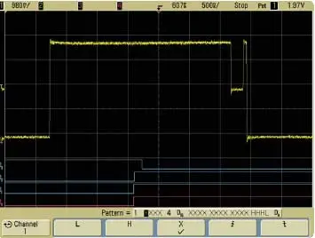

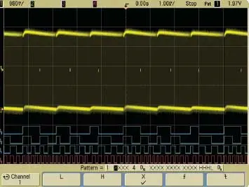

   The visual effects of a digital oscilloscope’s intensity gradation capability are most dramatic when you view complex-modulated analog signals such as the composite video and motor drive signals just shown. However, intensity gradation is also extremely important for uncovering signal anomalies when you are debugging digital circuitry. Figure 10 shows an example of uncovering a runt pulse embedded within a pulse-width modulated signal (PWM). The bright spot near the center of each burst is an indication that our scope has captured a signal anomaly. By zooming-in on one of the bright spots, we can clearly see details of the signal anomaly, as shown in Figure 11. Although an analog oscilloscope will also show the bright spots with repetitive sweeps, the analog scope is incapable of zooming-in on stored waveforms.
Figure 10. Agilent 6000 Series scope reveals “bright spots” buried within each digital burst
Figure 11. Zooming-in on a “bright spot” reveals a runt pulse

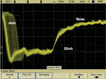

   Display intensity gradation is also very important when you view waveforms that contain jitter, noise, and infrequent events. Levels of display intensity can help you interpret the relative frequency of occurrence of signal anomalies, and sometimes it can help you visually determine the type of jitter or noise in your system – based on display intensity dispersion – without resorting to sophisticated waveform analysis software.
   Figure 14 shows an example of a digital signal that includes timing jitter (near the left side of screen), vertical noise (top and bottom of waveform), and a very infrequent glitch (near the center of screen). Because of the relative dimness of the displayed glitch, we know that this particular glitch occurs very infrequently. We can also see that the nature of the jitter is very complex and probably includes a large component of deterministic jitter (DJ). If the dispersion of display intensity on the signal’s edge appeared to be Gaussian in distribution, we would suspect that the jitter might be dominated by random jitter (RJ). For a more in-depth discussion on the different types of jitter, refer to Application Note 1448-2, “Finding Sources of Jitter with Real-Time Jitter Analysis,” listed at the end of this document.

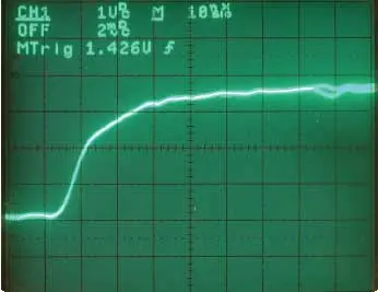

   Figure 15 shows the same signal displayed on an analog oscilloscope. Unfortunately, we are unable to show the jittering edge because it occurs before the trigger reference point (rising edge). But the signal edge that sometimes produces the infrequent glitch can be viewed. However, we can’t see the glitch on the analog scope’s display because it occurs too infrequently for conventional analog scope technology to display, even with the display intensity adjusted to full brightness.
Figure 14. Display intensity gradation shows characteristics of jitter, noise, and signal anomalies on Agilent’s 6000 Series oscilloscope
Figure 15. The analog oscilloscope fails to show the infrequent glitch
