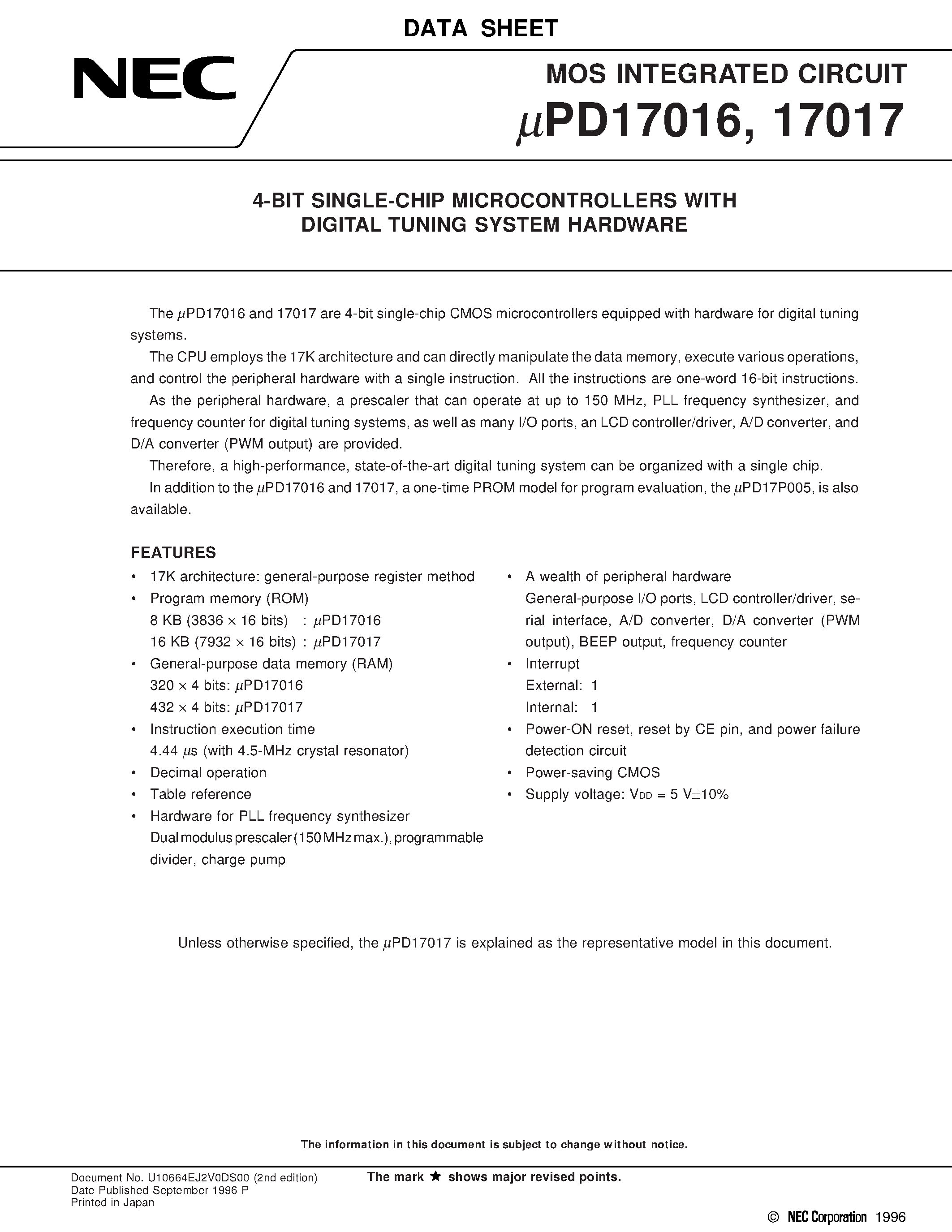

UPD17016-4-BIT SINGLE-CHIP MICROCONTROLLERS WITH DIGITAL TUNING SYSTEM HARDWARE
Producer:NEC
Description:4-BIT SINGLE-CHIP MICROCONTROLLERS WITH DIGITAL TUNING SYSTEM HARDWARE
Others with the same file: UPD17016
Datasheet UPD17016 - 4-BIT SINGLE-CHIP MICROCONTROLLERS WITH DIGITAL TUNING SYSTEM HARDWARE page 1
