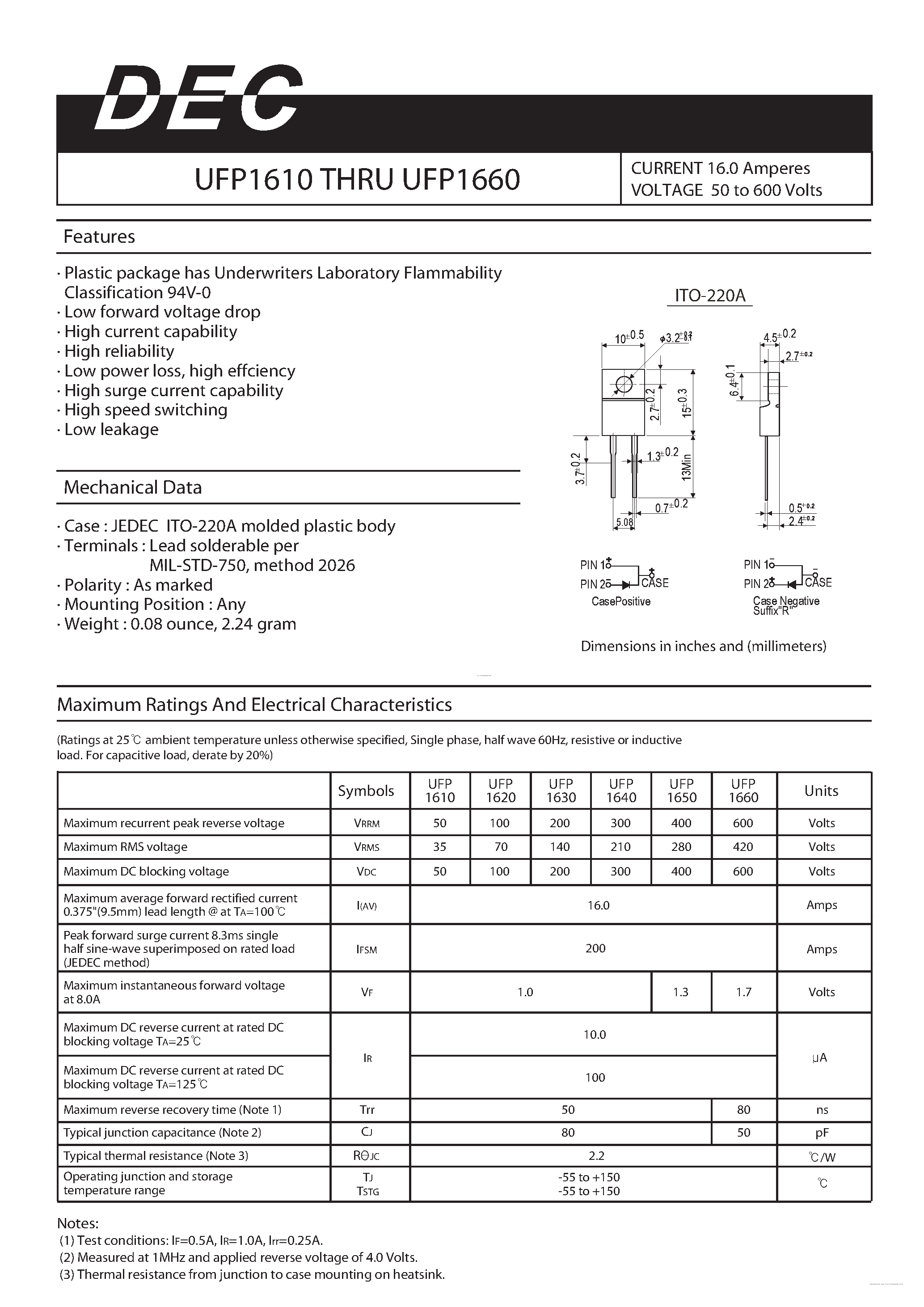

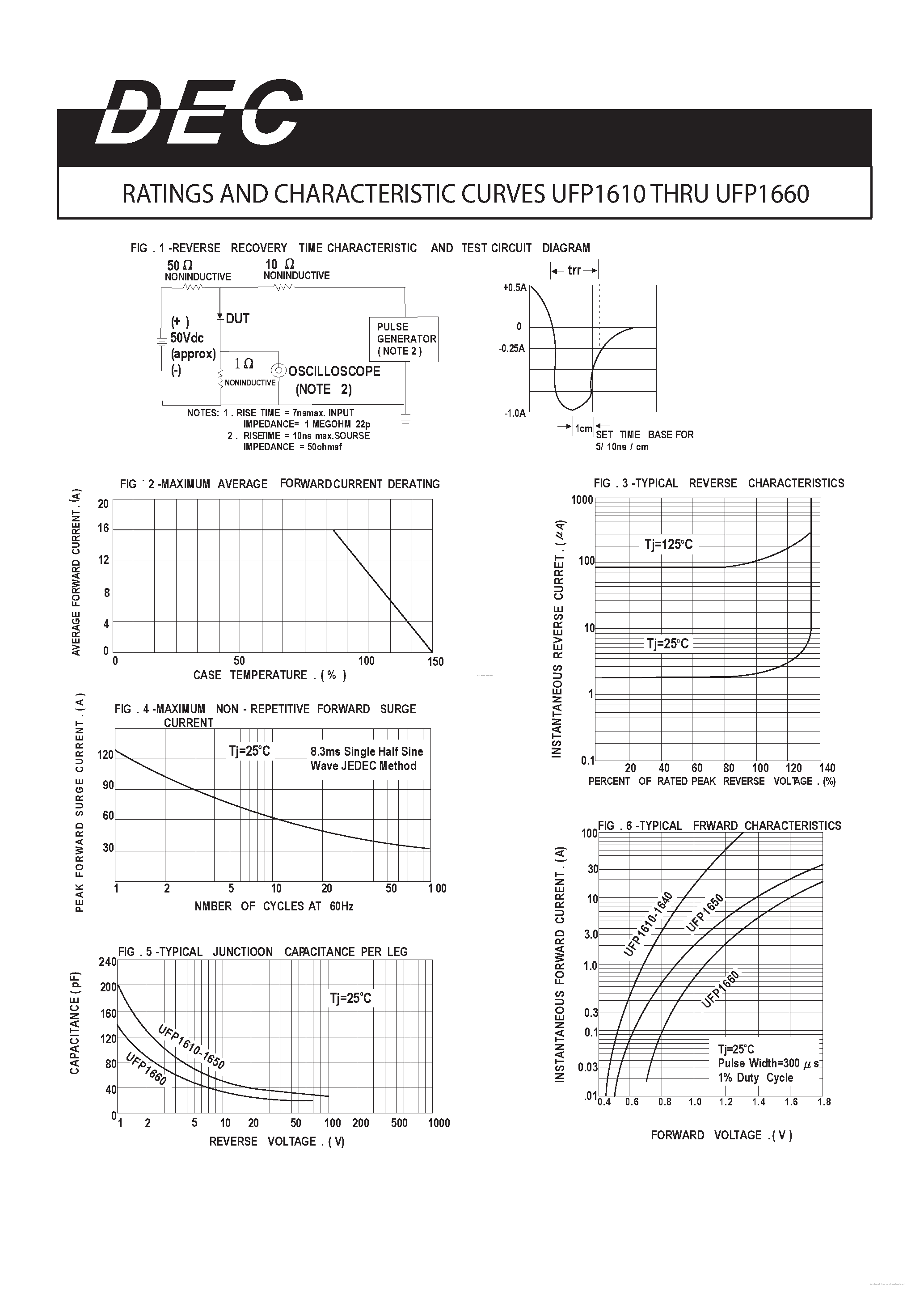

UFP1610-(UFP1610 - UFP1660) CURRENT 16.0 AMPERES VOLTAGE 50 TO 600 VOLTS
Producer:DEC
Description:(UFP1610 - UFP1660) CURRENT 16.0 AMPERES VOLTAGE 50 TO 600 VOLTS
