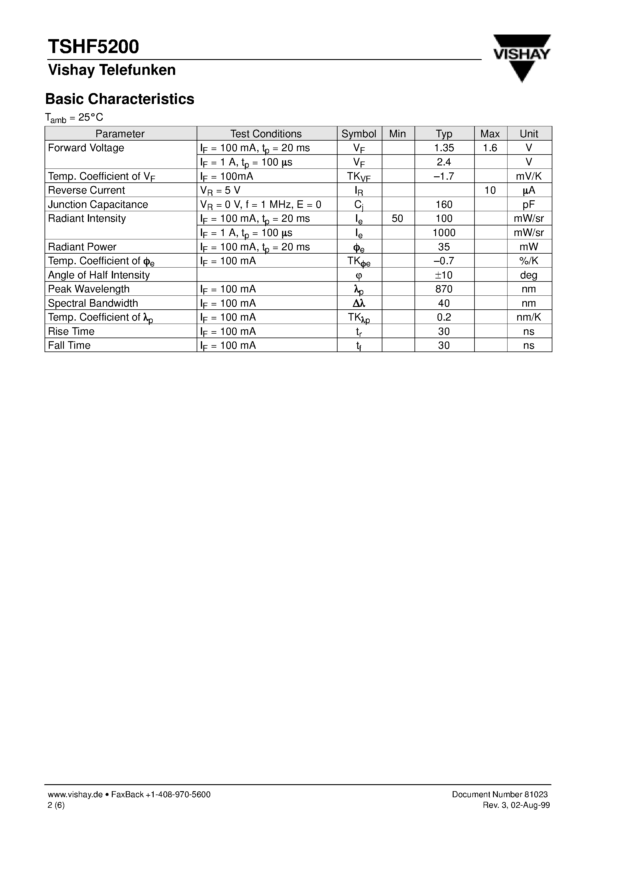

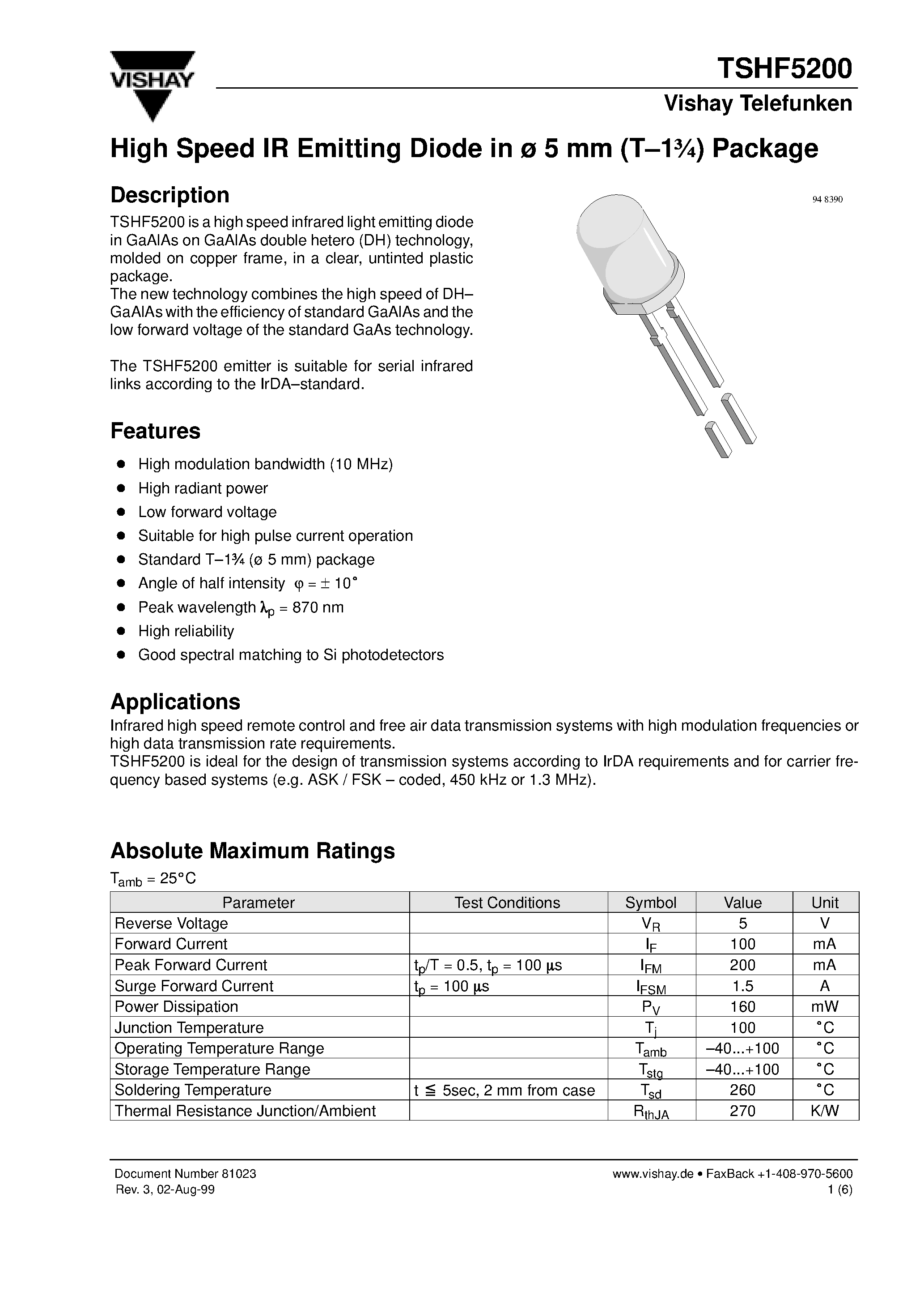

TSHF5200-High Speed IR Emitting Diode in 5 mm (T-13/4) Package
Producer:Vishay Telefunken
Description:High Speed IR Emitting Diode in 5 mm (T-13/4) Package
Others with the same file: TSHF5200
Datasheet TSHF5200 - High Speed IR Emitting Diode in 5 mm (T-13/4) Package page 1
Datasheet TSHF5200 - High Speed IR Emitting Diode in 5 mm (T-13/4) Package page 2
