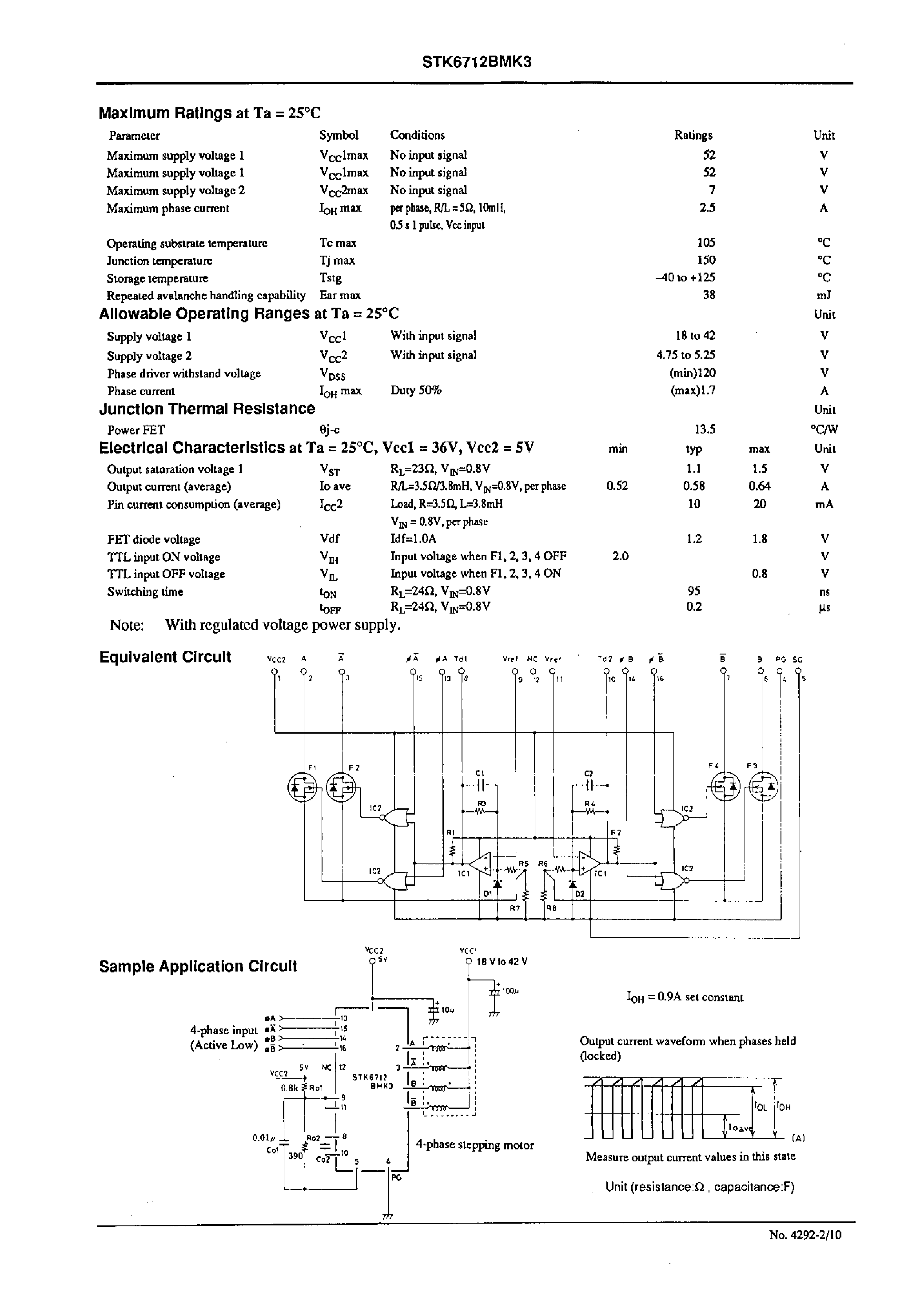

STK6712BMK3-Unipolar Fixed-current Chopper-type 4-phase Stepping Motor Driver
Producer:Sanyo Semicon Device
Description:Unipolar Fixed-current Chopper-type 4-phase Stepping Motor Driver
