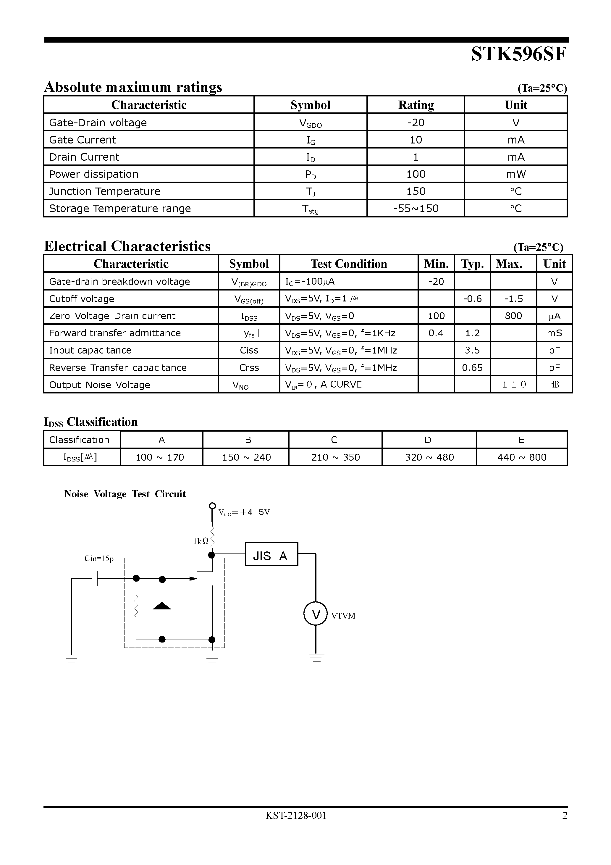

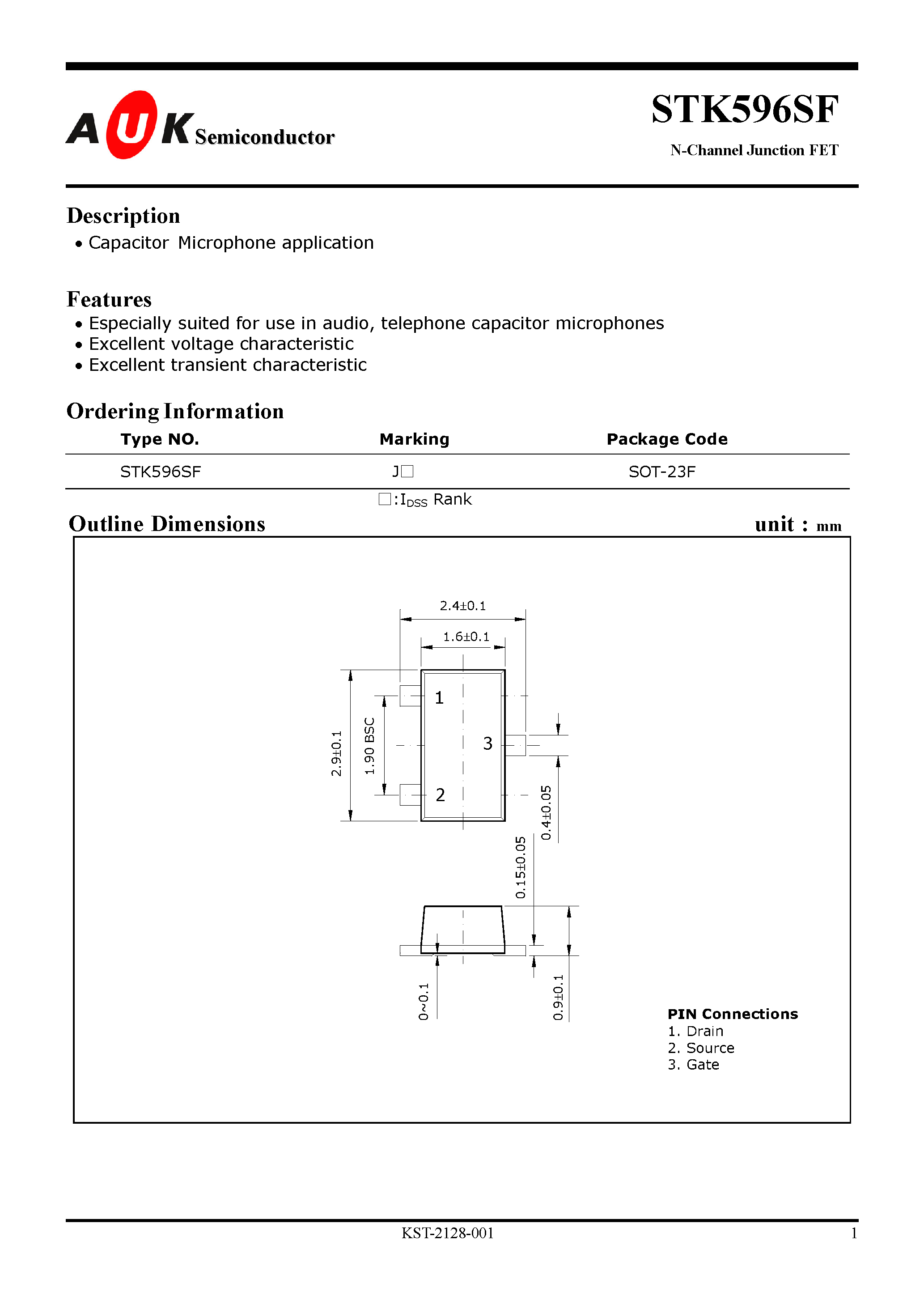

Datasheet STK596SF - N-Channel Junction FET page 1
Datasheet STK596SF - N-Channel Junction FET page 2
