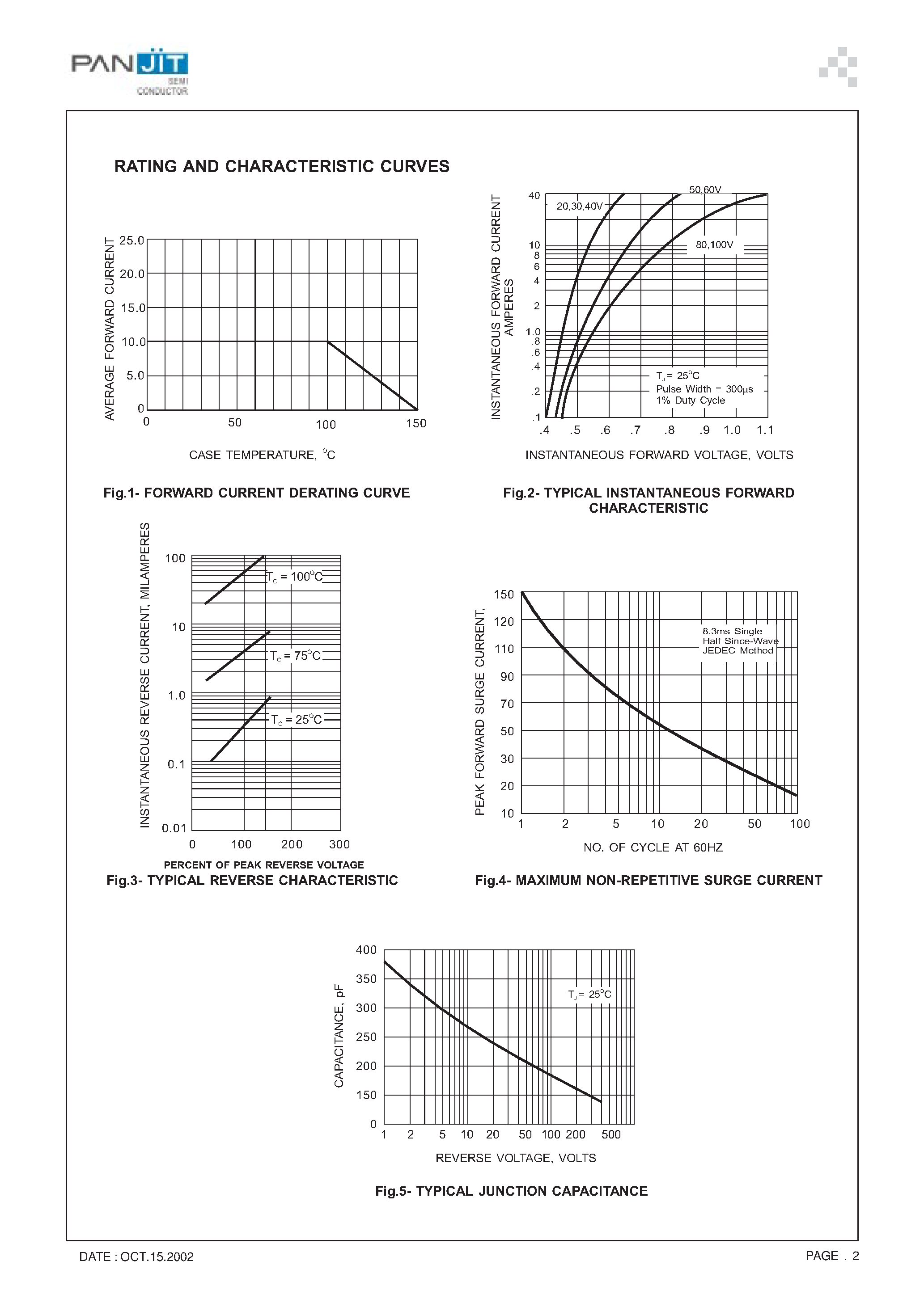

Datasheet SB10100F - ISOLATION SCHOTTKY BARRIER RECTIFIERS(VOLTAGE- 20 to 100 Volts CURRENT - 10.0 Ampere) page 2
