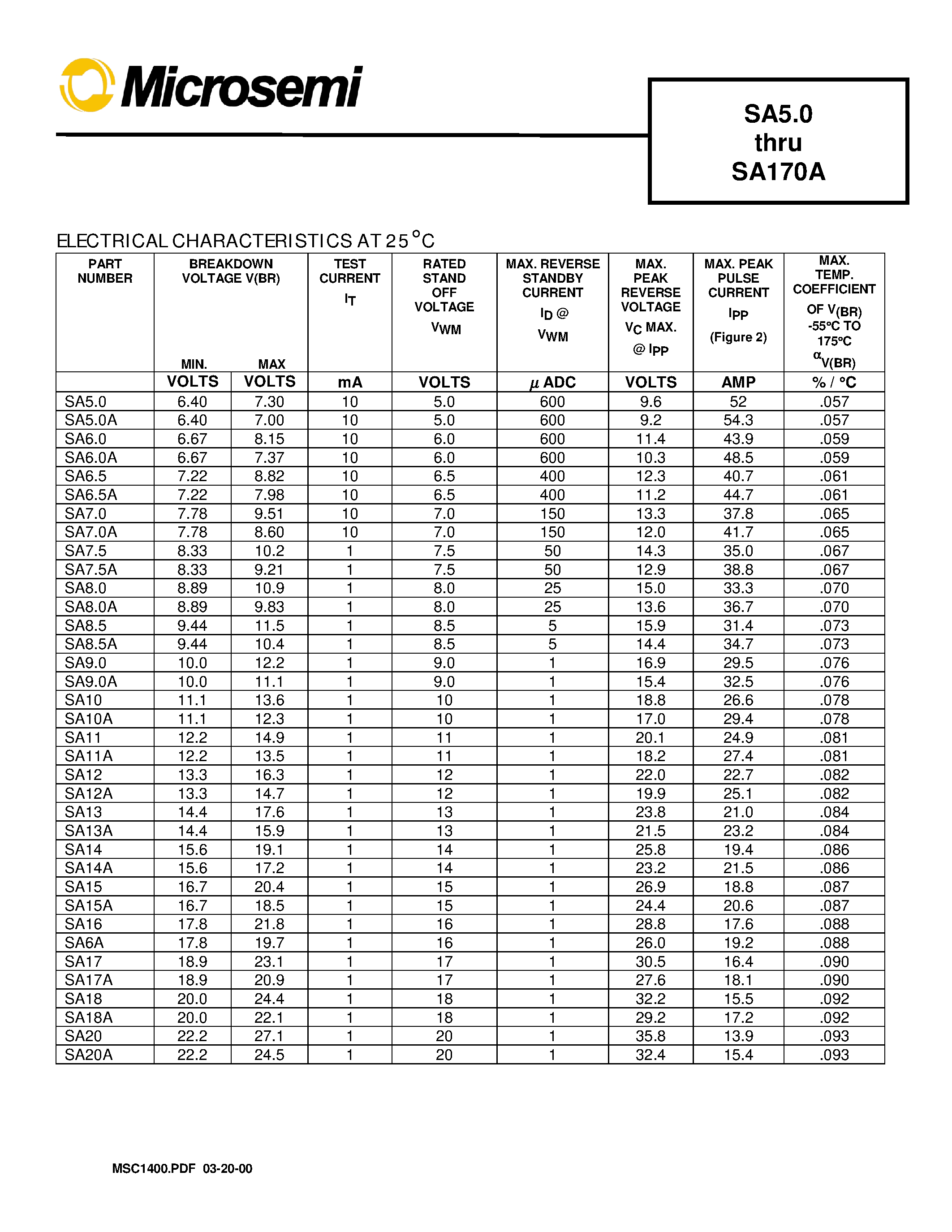

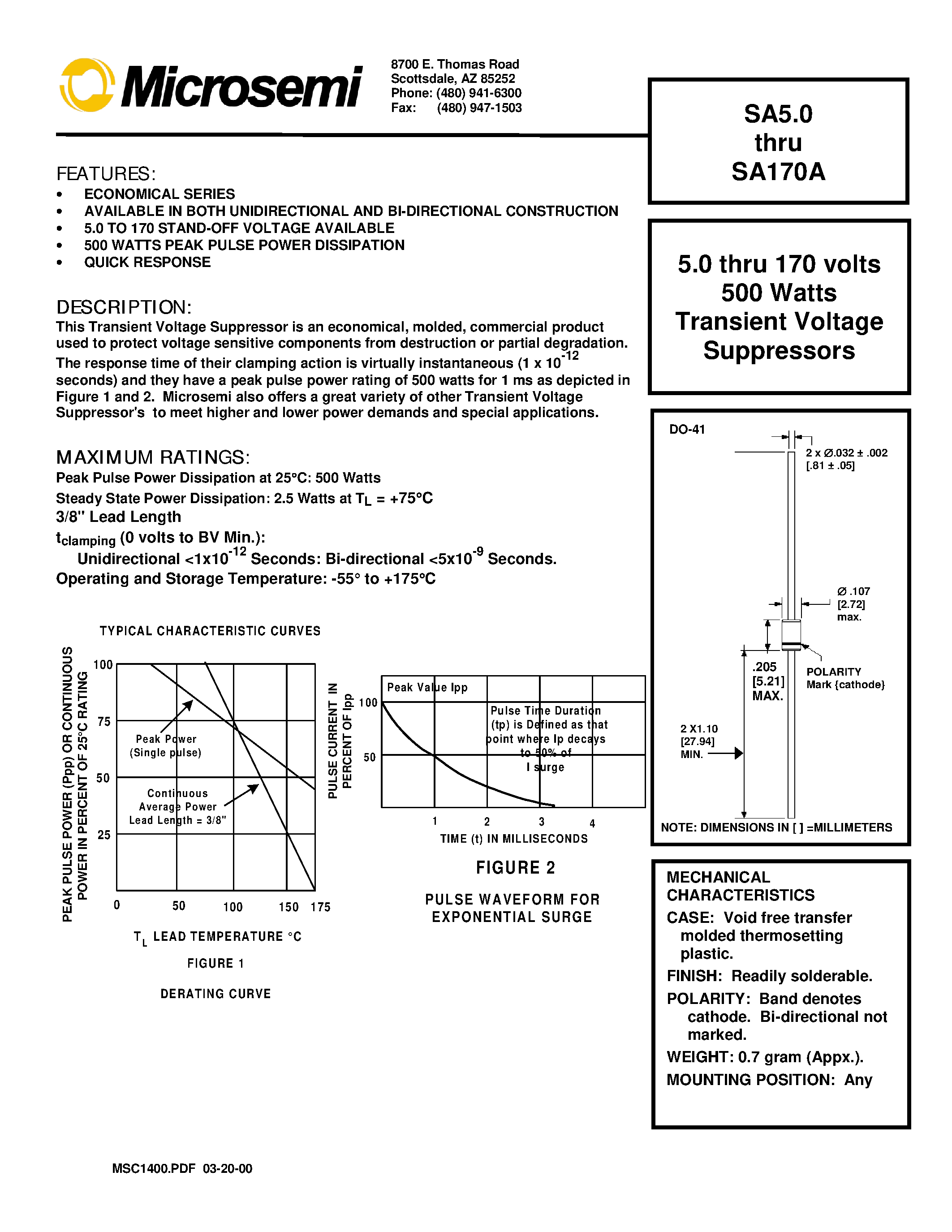

SA120-5.0 thru 170 volts 500 Watts Transient Voltage Suppressors
Description:5.0 thru 170 volts 500 Watts Transient Voltage Suppressors
Others with the same file: SA120
