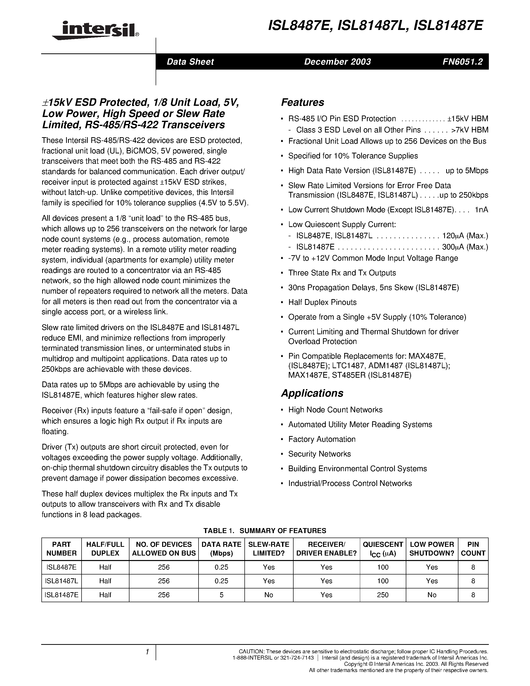

ISL81487EIB-15kV ESD Protected/ 1/8 Unit Load/ 5V/ Low Power/ High Speed or Slew Rate Limited/ RS-485/RS-422 Transceivers
Producer:Intersil Corporation
Description:15kV ESD Protected/ 1/8 Unit Load/ 5V/ Low Power/ High Speed or Slew Rate Limited/ RS-485/RS-422 Transceivers
