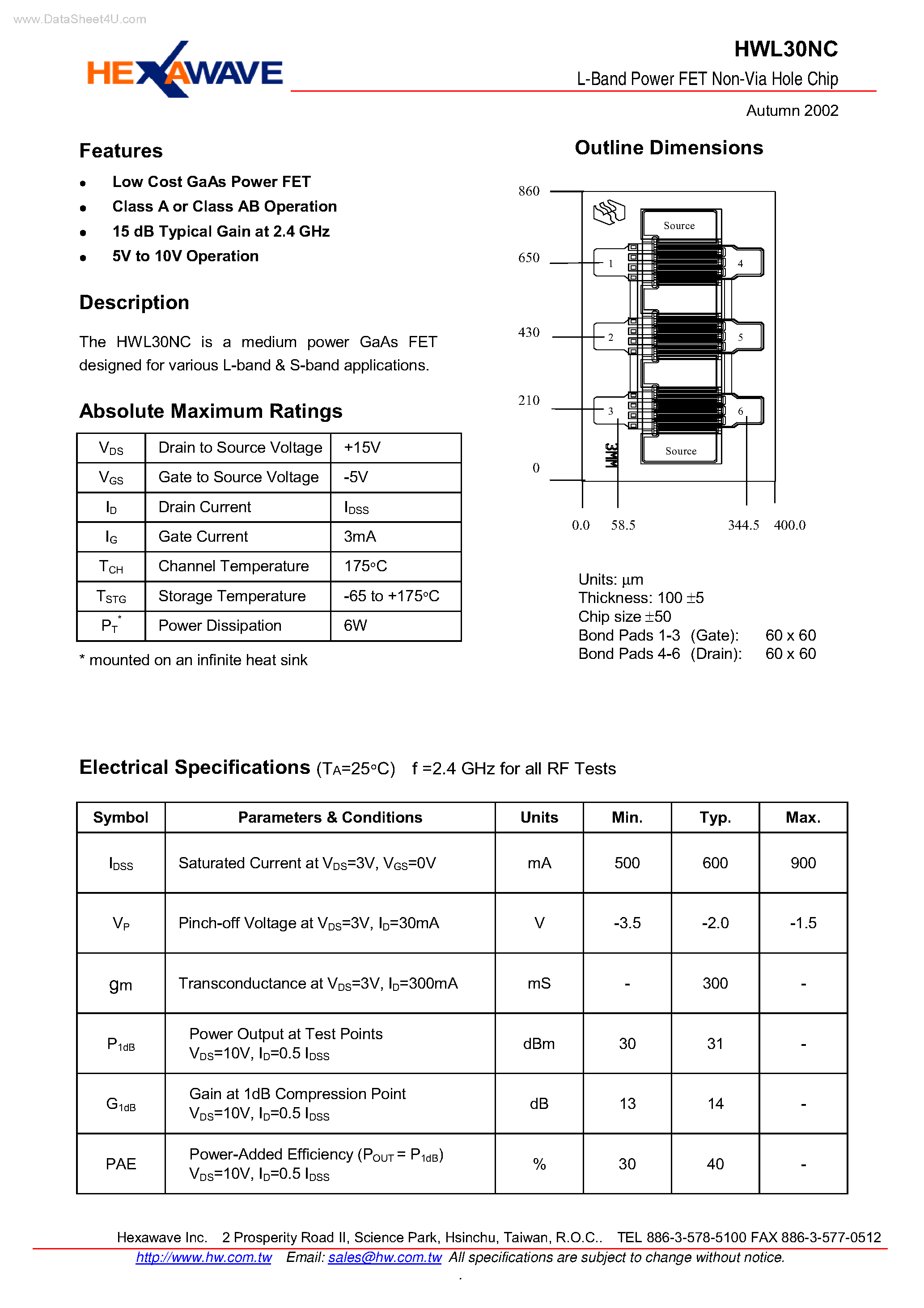

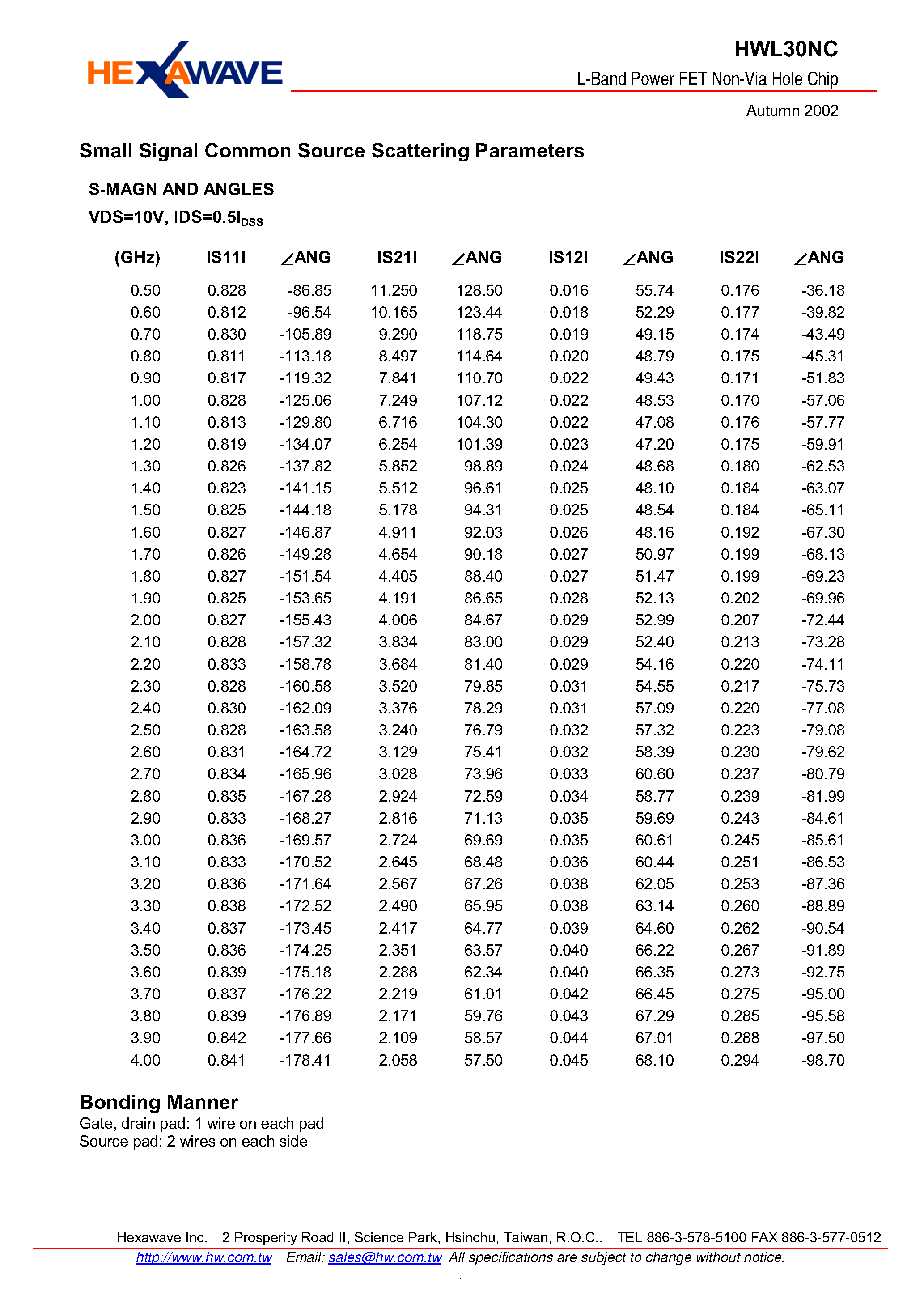

HWL30NC-L-Band Power FET Non-Via Hole Chip
Producer:Aimtron Technology
Description:L-Band Power FET Non-Via Hole Chip
Others with the same file: HWL30NC
