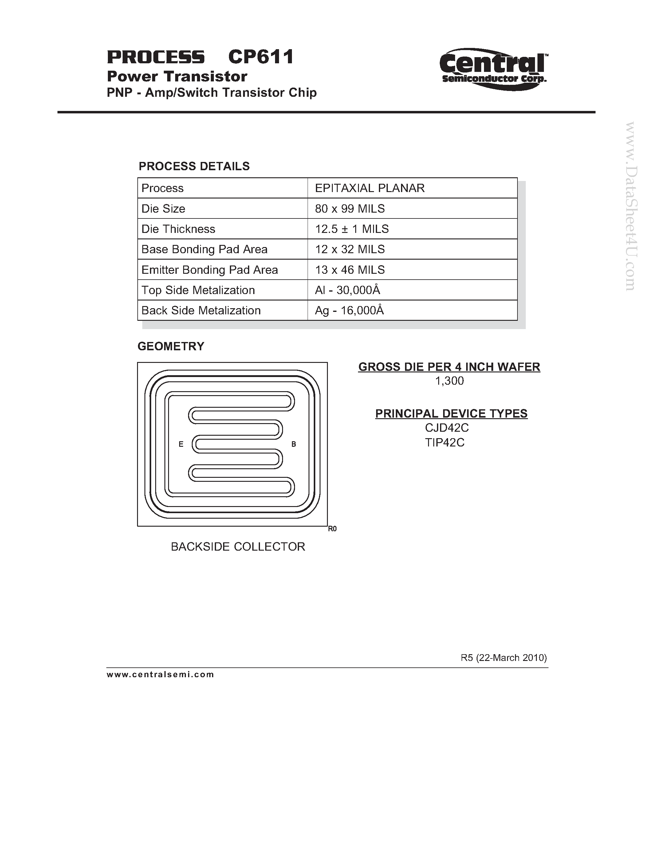

CP611-Power Transistor PNP - Amp/Switch Transistor Chip
Producer:Central Semiconductor
Description:Power Transistor PNP - Amp/Switch Transistor Chip
Others with the same file: CP611
Datasheet CP611 - Power Transistor PNP - Amp/Switch Transistor Chip page 1

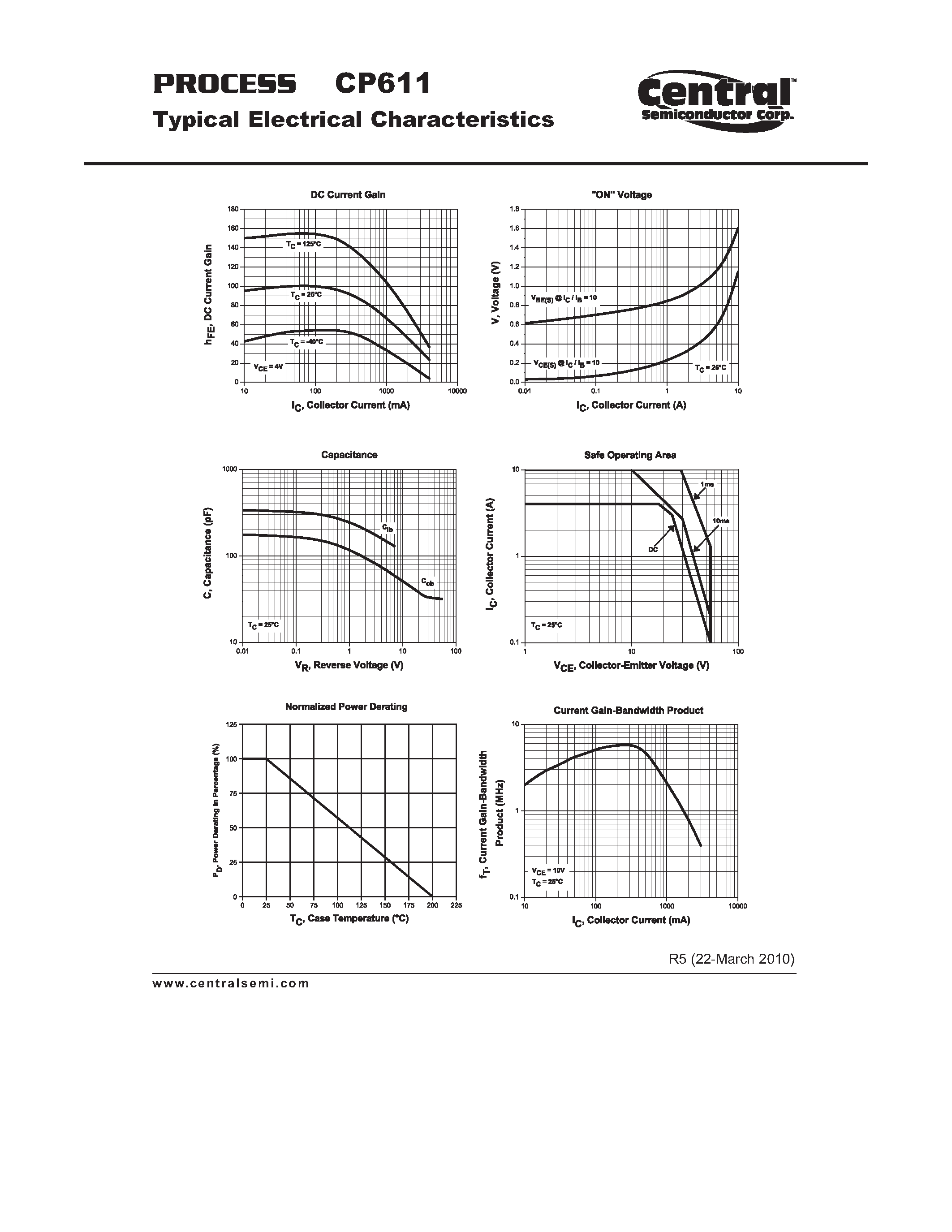

Datasheet CP611 - Power Transistor PNP - Amp/Switch Transistor Chip page 2
