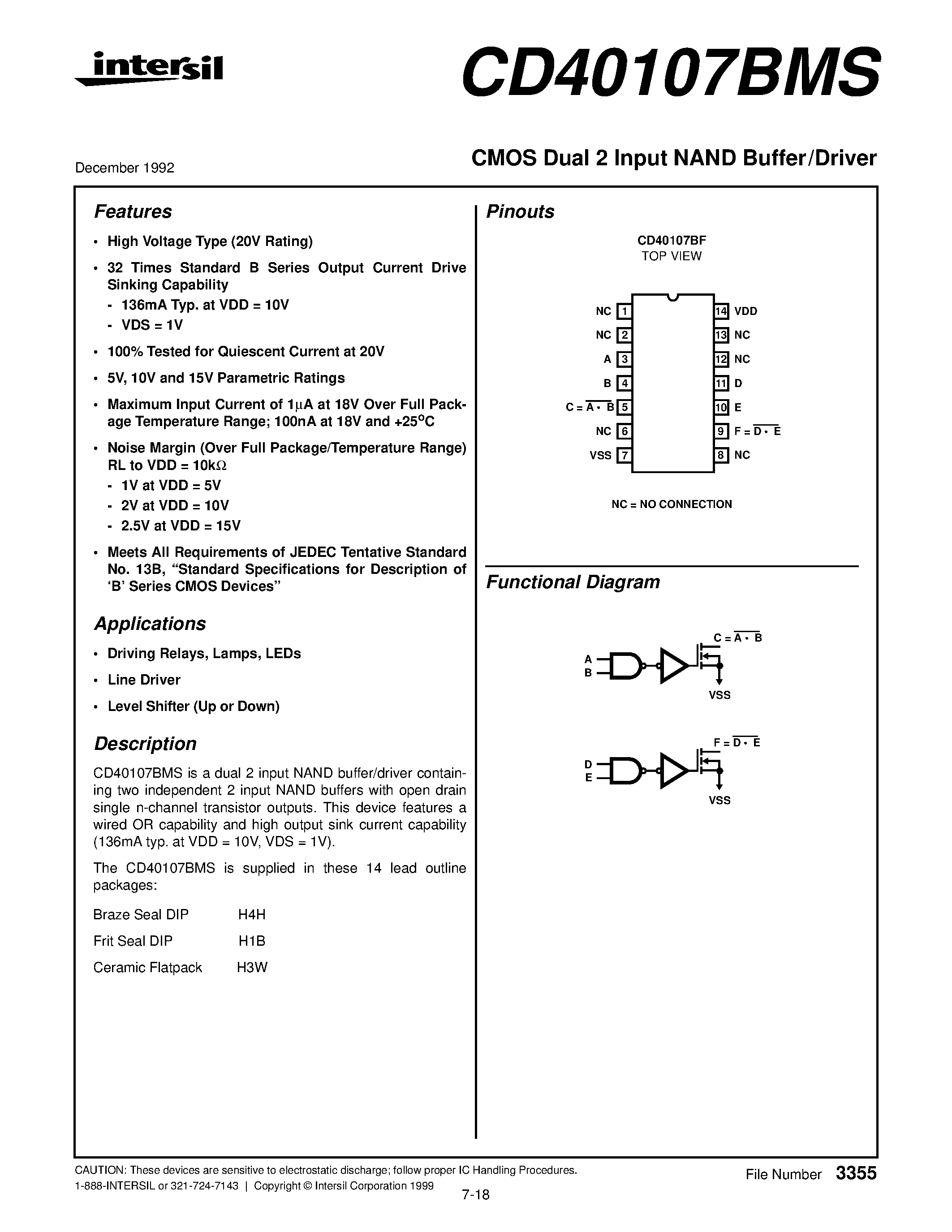

CD40107BMS-CMOS Dual 2 Input NAND Buffer/Driver
Producer:Intersil Corporation
Description:CMOS Dual 2 Input NAND Buffer/Driver
Others with the same file: CD40107BMS

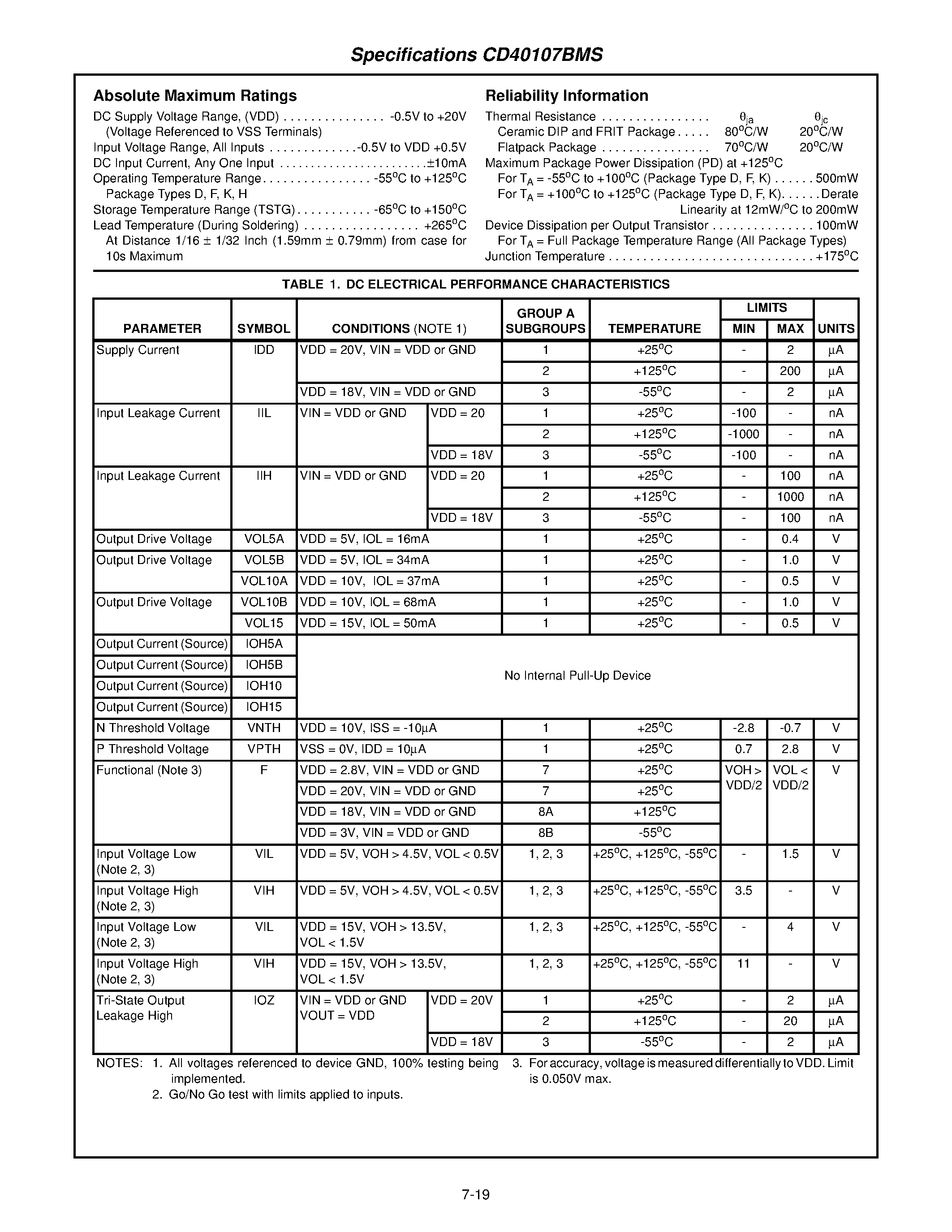

Datasheet CD40107BMS - CMOS Dual 2 Input NAND Buffer/Driver page 1
Datasheet CD40107BMS - CMOS Dual 2 Input NAND Buffer/Driver page 2
