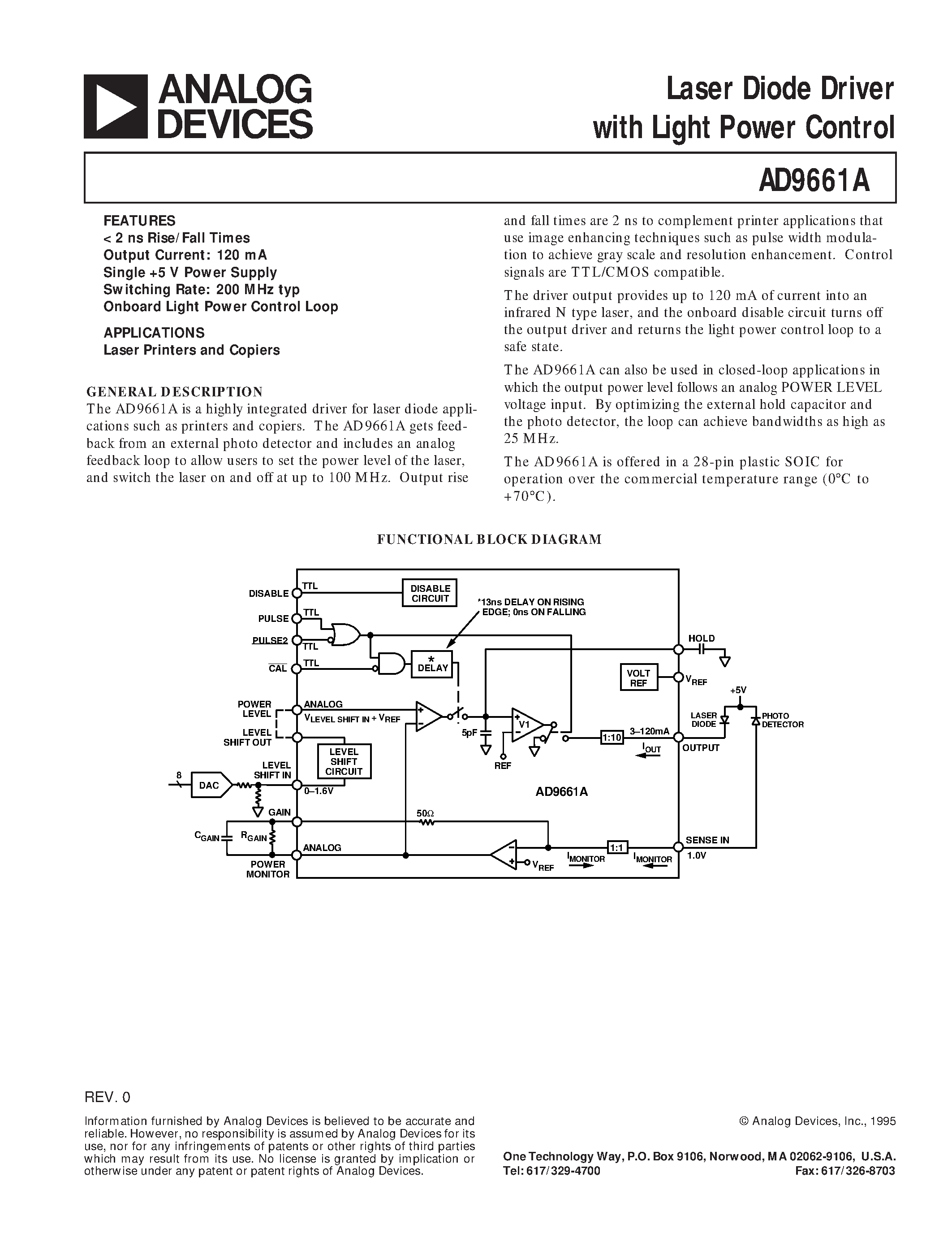

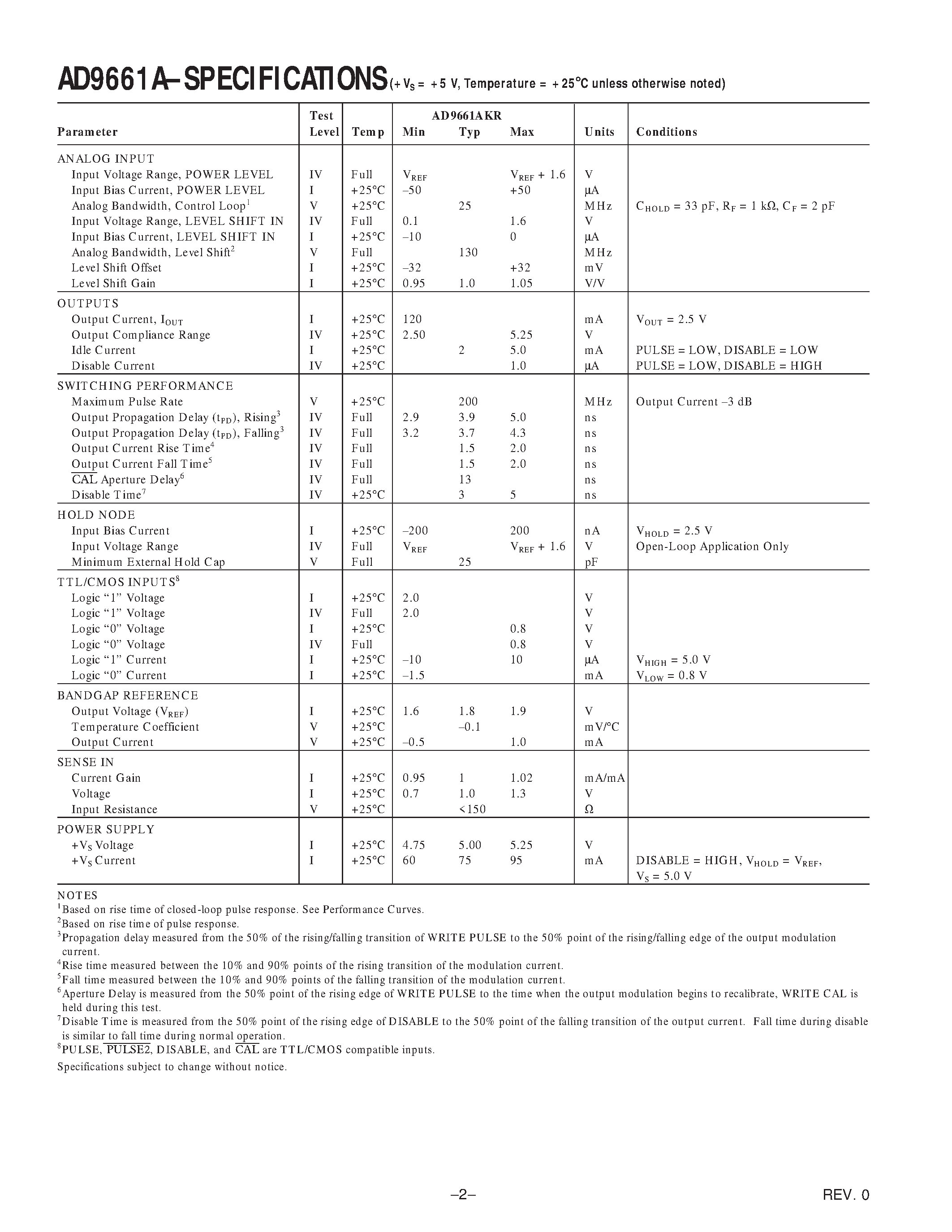

AD9661A-Laser Diode Driver with Light Power Control
Producer:Analog Devices
Description:Laser Diode Driver with Light Power Control
Others with the same file: AD9661A
Datasheet AD9661A - Laser Diode Driver with Light Power Control page 1
Datasheet AD9661A - Laser Diode Driver with Light Power Control page 2
