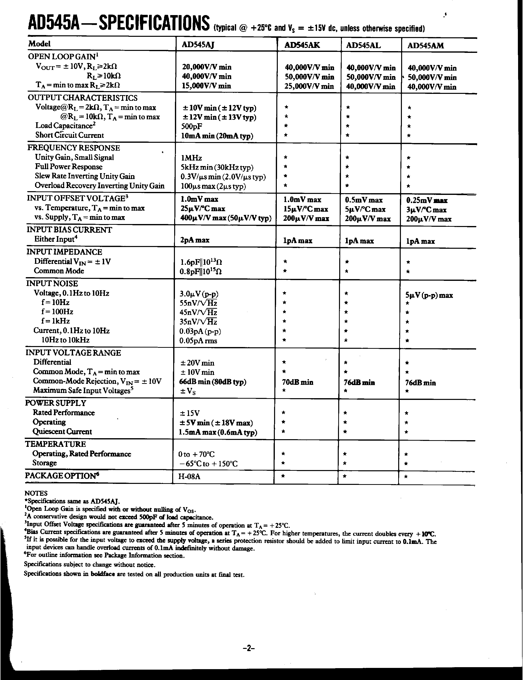

AD545AJ-Monolithic Precision/ Low Drift FET-Input Op Amp
Producer:Analog Devices
Description:Monolithic Precision/ Low Drift FET-Input Op Amp
