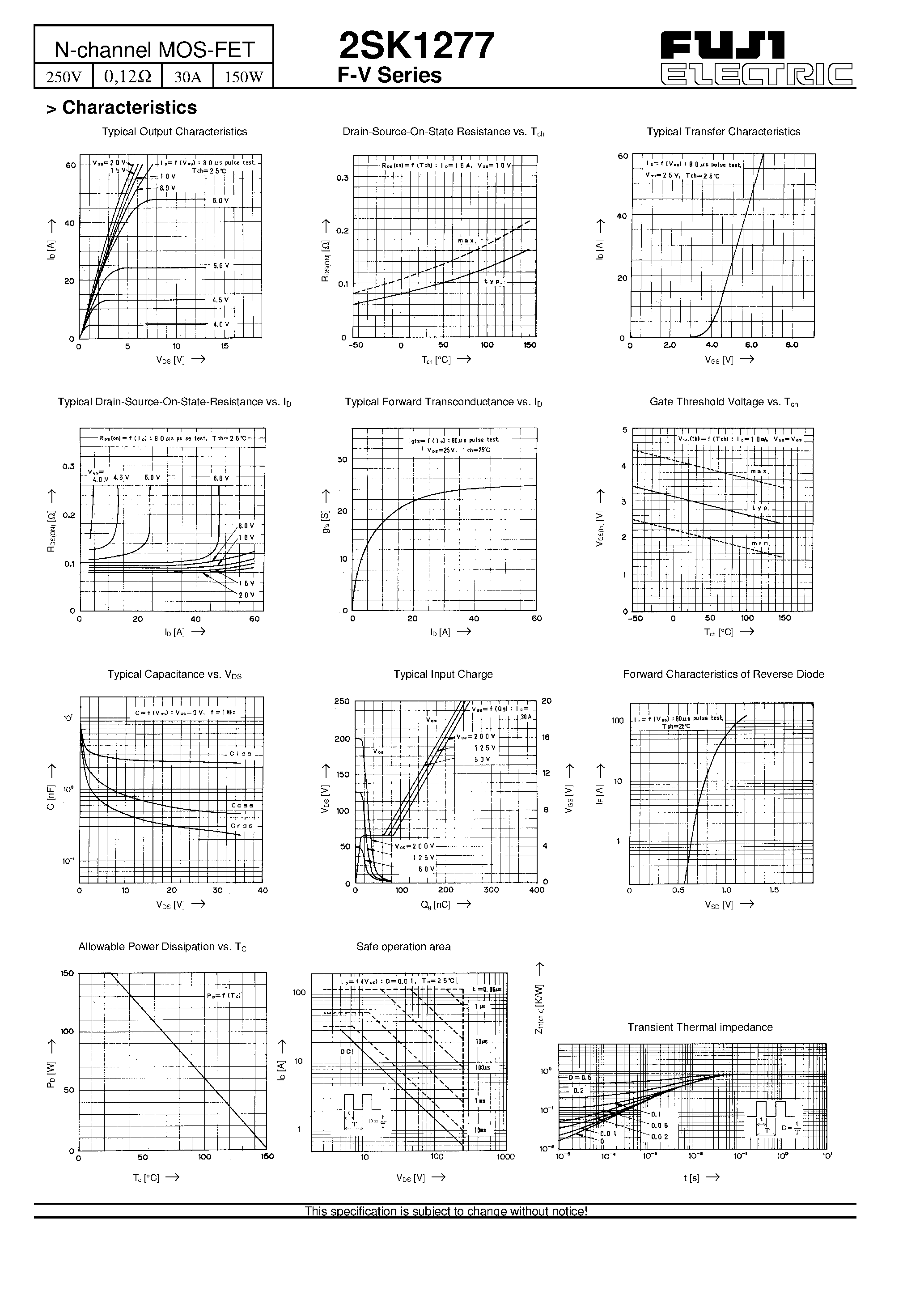

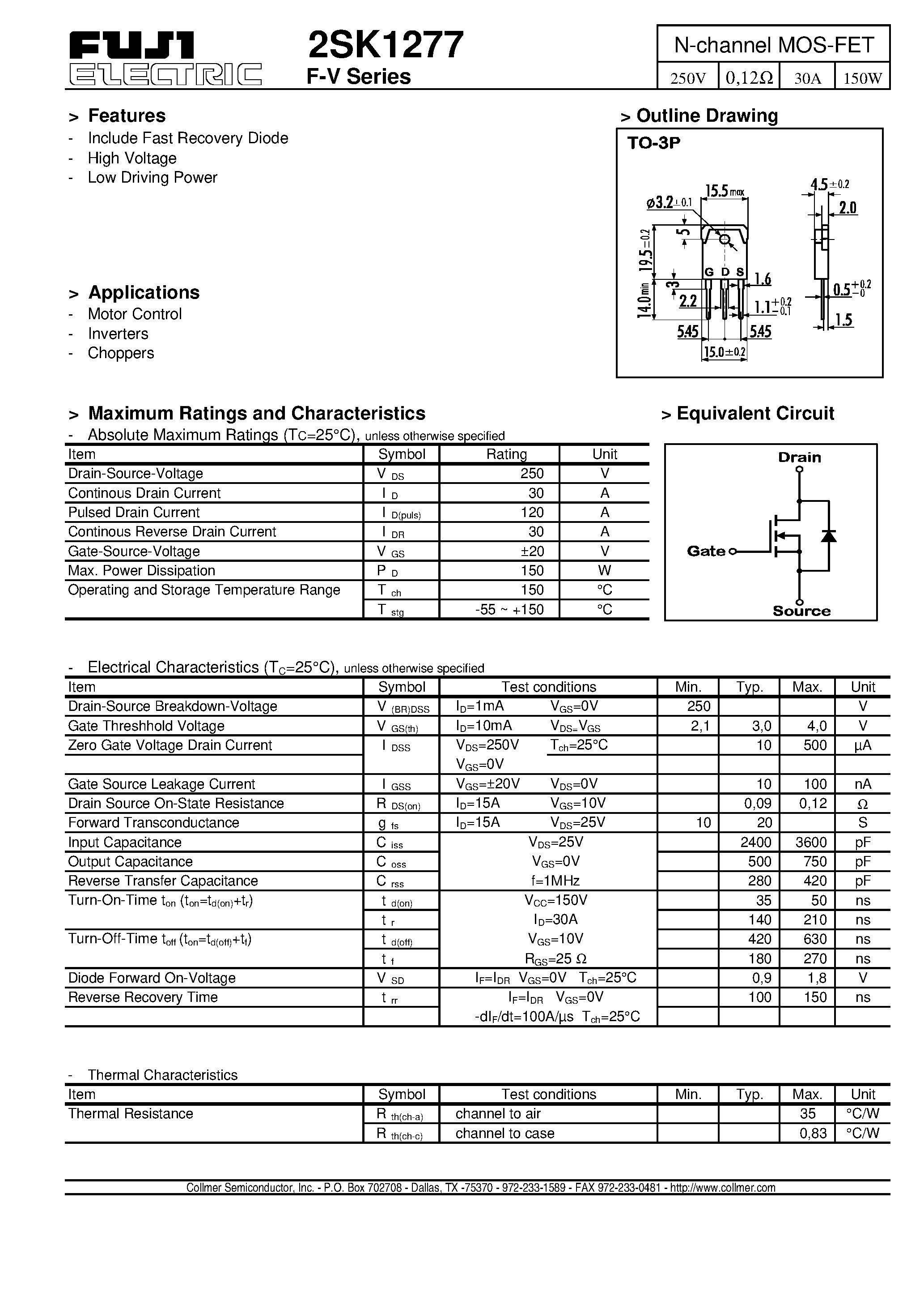

2SK1277-N-Channel MOS-FET(250V/ 0.12Ohm/ 30A/ 150W)
Producer:Fuji Electric
Description:N-Channel MOS-FET(250V/ 0.12Ohm/ 30A/ 150W)
Others with the same file: 2SK1277
Datasheet 2SK1277 - N-Channel MOS-FET(250V/ 0.12Ohm/ 30A/ 150W) page 1
Datasheet 2SK1277 - N-Channel MOS-FET(250V/ 0.12Ohm/ 30A/ 150W) page 2
